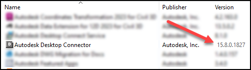

Check Desktop Connector to see what version you are currently running. You can hover your cursor over the Desktop Connector tray icon to view the installed version number as shown. In this example we have installed Desktop Connector version 15.8.0.1827.
Check Installed Version
You can also view the version number in the Control Panel > Programs > Programs and Features.
Installed Version in Control Panel

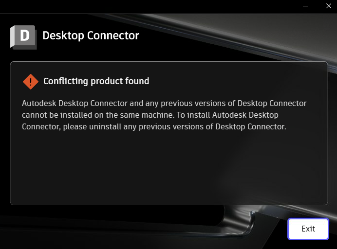

If you are on a v15.x or prior of Desktop Connector and try to upgrade to a v16.x of Desktop Connector you will receive the following warning.
You will need to do a complete uninstall of Desktop Connector before upgrading.
