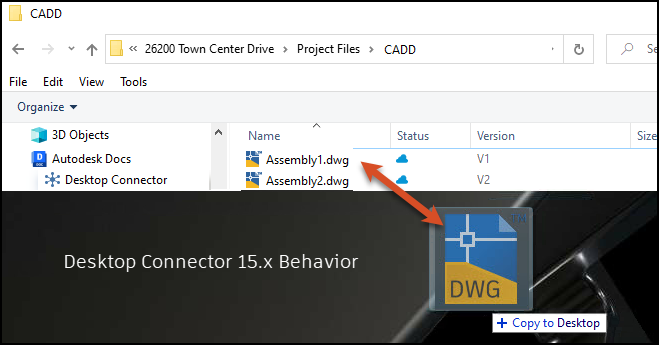

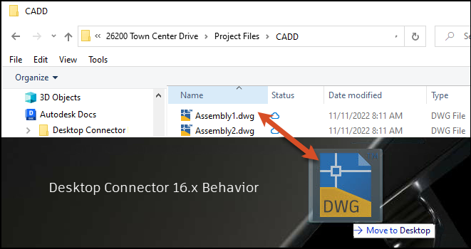

The default command when dragging and dropping files/folders in Desktop Connector 16.x is now "Move". This matches the default behavior when using Windows File Explorer
Warning: Moving files or folders from the Autodesk Docs Connector to a location on your local machine (that is, Desktop, Documents, etc.), that is not managed by Desktop Connector, will result in data being deleted from the cloud. Essentially you have told Desktop Connector to move the data to the new location and remove it from Autodesk Docs.Tip:It is recommended to hold the Control
(CTRL)
key when performing a drag and drop to make certain a copy of the data is made instead of moving it. When using Desktop Connector 15.x versions, the default behavior for a drag and drop was "Copy".The following images highlight the differences when using File Explorer (drag and drop) with Desktop Connector versions 15.x and 16.x. The example shows the behavior when dragging and dropping a file from Desktop Connector to your local desktop.

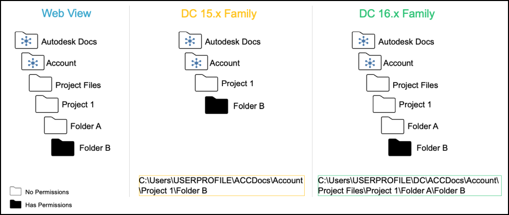

- Desktop Connector 16.x will now display the full folder path for folders even if they don't have view permission, as long as they have permissions for at least one subfolder. This is a change in behavior compared to 15.x which would truncate the path to hide folders you do not have permission to view.
- Files contained in folders set as View & Download permission will not be set as read-only on the local machine. Users will be able to make changes to the local files. An upload will be attempted but result in a failure displayed in the home screen as the user does not have permission.

- Due to changes in 16.x it is recommended but not required that everyone moves up to 16.x at the same time.
- With the changes around permissions, users in 15.x may have paths truncated while 16.x will contain the full path.
