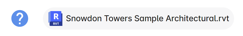

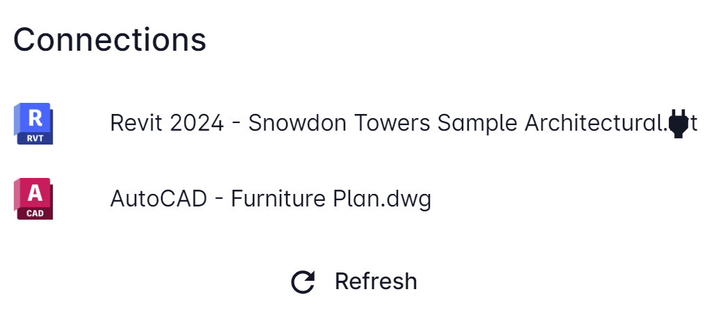

Next, find the connection icon in the top right.
It shows the application currently connected. Click the icon to verify your connection or switch to another open application.

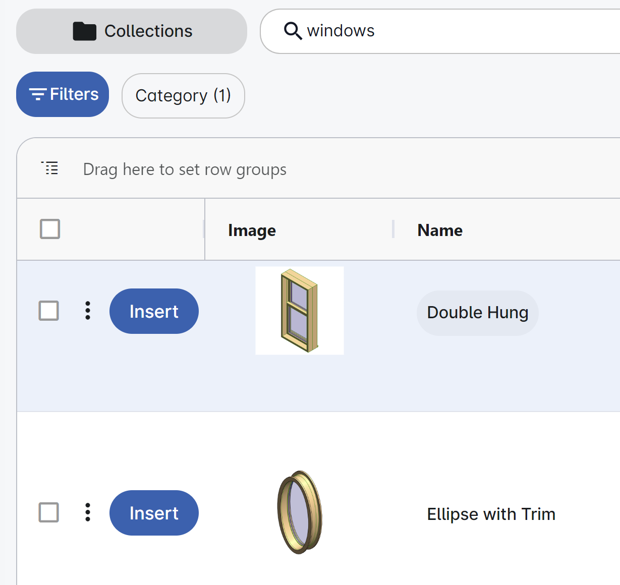

To insert content from Content Catalog, you will need to Search, Browse or open a Saved Search to find the content you wish to insert.

- While in the search results or file details locate the "Insert" button.
- Select the insert button to insert the content directly into your connected application.

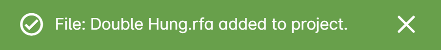

- A confirmation message will appear in Content Catalog and your content will appear at the location of your cursor for individual place able items or content will load and appear in the connected application.
