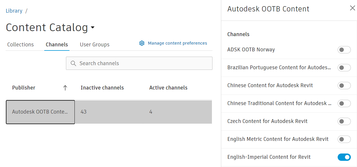

As an ACC Account Admin or Standards Admin, navigate to the Account Admin > Library > Content Catalog > Channels Tab, to enable any Channels you would like to allow access to
- Select the Publisher as seen below
- Select the toggle in the flyout to the right to subscribe

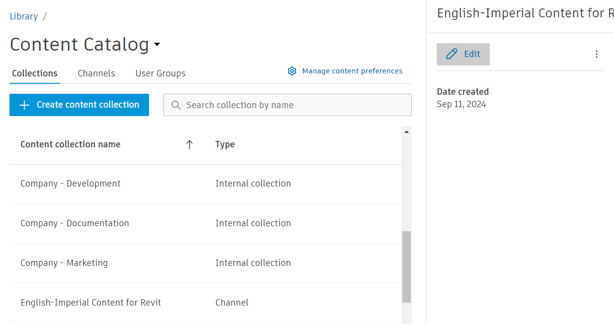

- The channel(s) will now appear in your Collections tab

You can add user groups with permissions to manage access of each channel you subscribed to from the Collections Tab.
Select the Channel > Edit in the flyout panel on the right

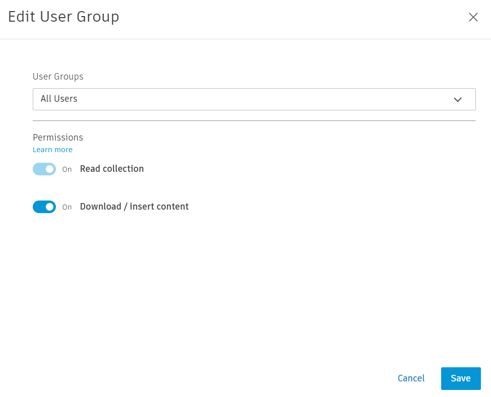

Select Add User Groups to add the groups you wish to have access
Set the Permissions and select Save
The use of User Group access control allows you to use Channels as a direct download or insert for your users. Alternatively, you can allow read only access and have them suggest content that an admin can review, update to company standards and make available in your content Collections.
