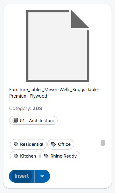

One-click insert
After previewing and selecting your desired content, you’re ready to insert it into your document.
Here’s how:

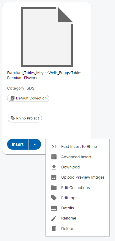

While in the search results or file details locate the "Insert" button.
- Select the insert button to insert the content directly into your connected application
- A confirmation message will appear in Content Catalog and your content will appear at the location of your cursor for individual place able items or content will load and appear in the connected application
Advanced insert
- Select the drop down next to the insert button
- Choose Advanced Insert

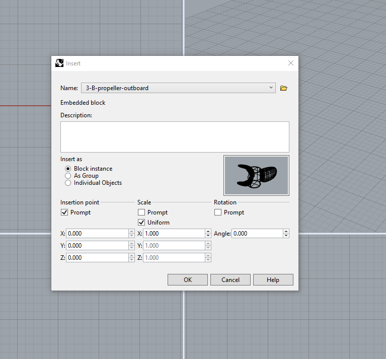

- A confirmation message will appear in Content Catalog and a dialog will appear in the Rhino as seen below
- From here you can choose how the content will be inserted, Block instance, Group, or Individual Objects
- You can also choose to set Manually or by prompt at your cursor, the insertion point, scale, or angle of the placement
- Select OK to proceed with insert and you content will appear as you indicated wither on your cursor or at the indicated location if "prompt" was not chosen
