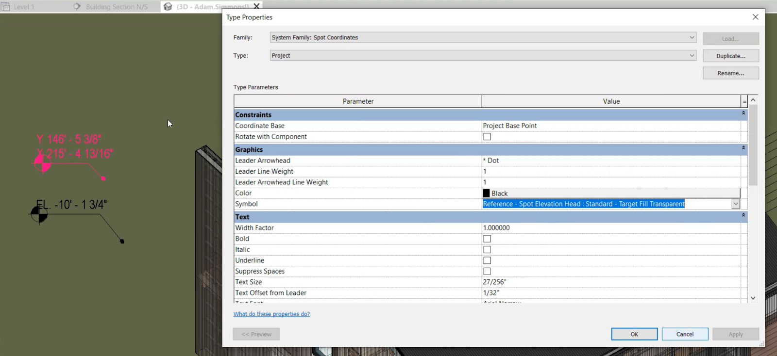

Spot coordinates
Since spot coordinates are more of a function in Revit, they are not directly saveable like most items we can export from Revit. You can, however, save the actual symbol for the spot coordinate.

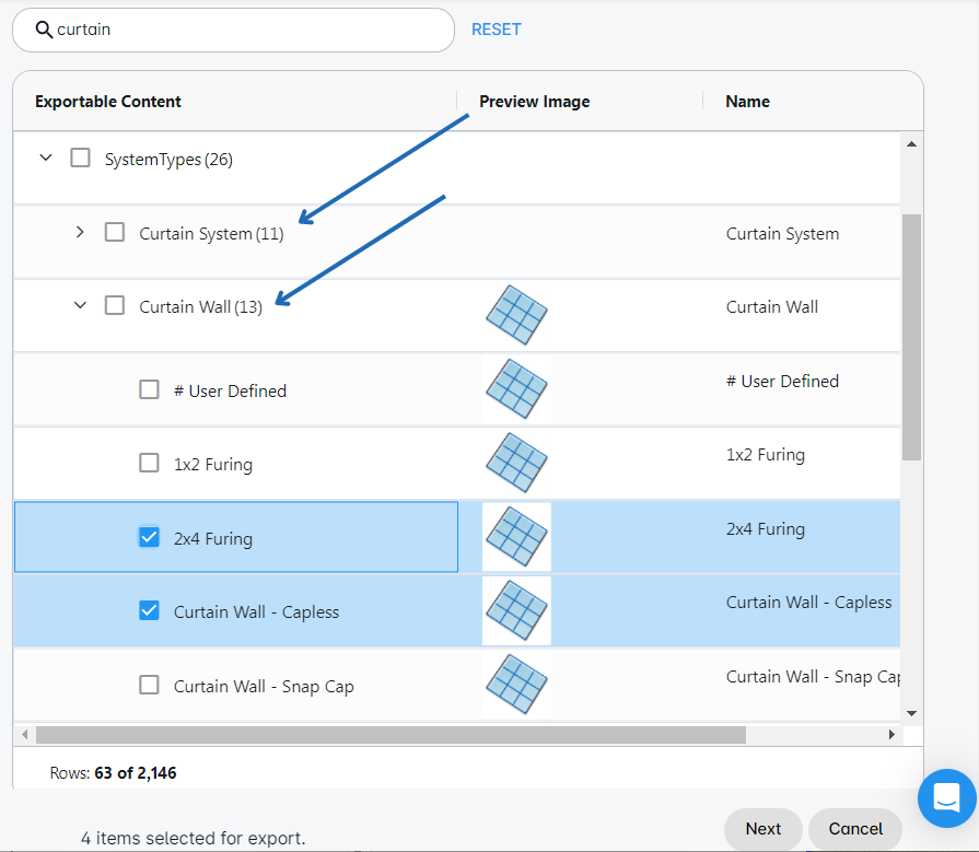

Curtains / mullions
To add curtains/mullions, Batch Export the curtain wall or curtain system.

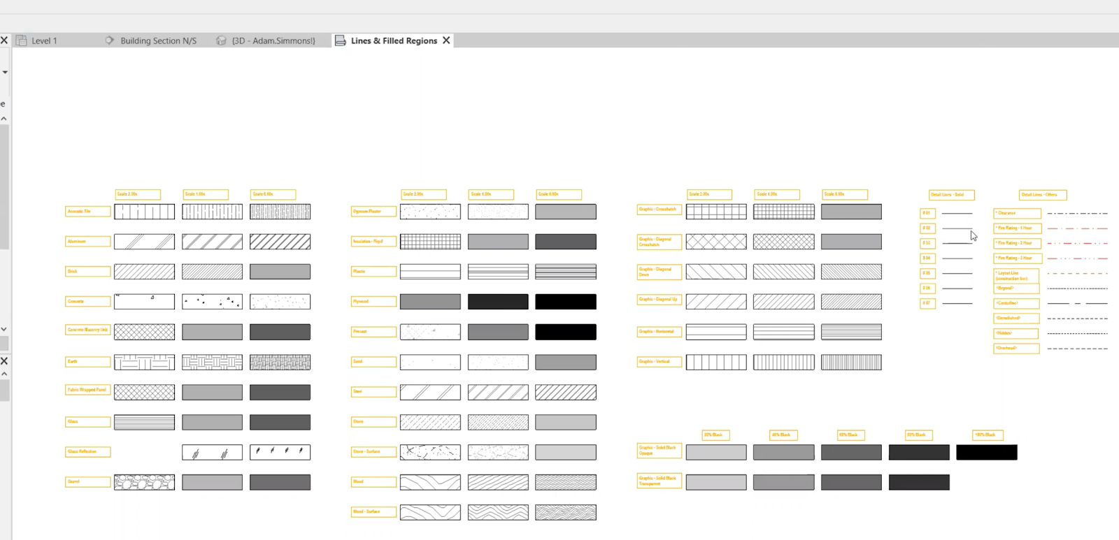

Filled regions, line weights & line patterns
To add filled regions, line weights, and line patterns to Content Catalog, lay all of them out on a drafting view and batch export that drafting view.
