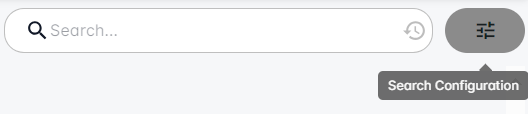

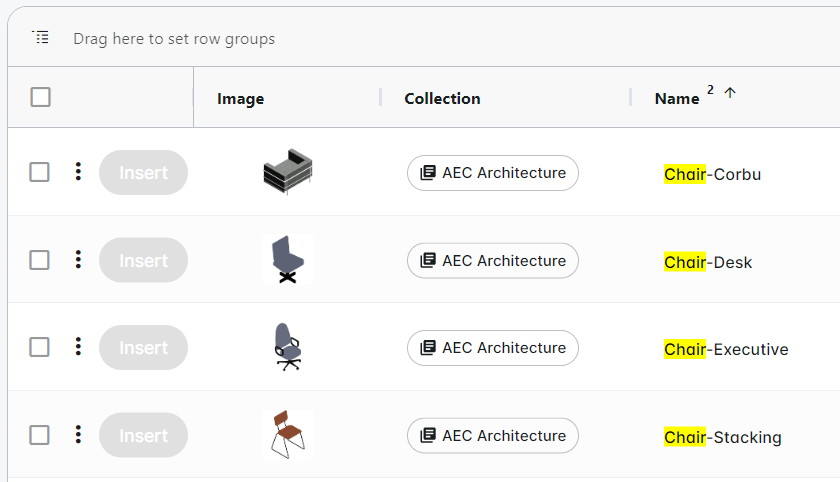

First ensure you are using Detail or Row Display mode in your search configuration. Select Search Configuration to the right of the search field.
Bulk Content Operations
Select Details or Row under the Display Mode settings.

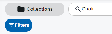

Select your Collections, search term and any Filters to get your desired search results.

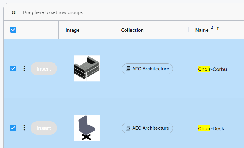

Use the selection boxes on the left to make your selection. The top box in the header location will select all or deselect all. The boxes next to content may be selected individually to select or deselect an item and Shift+Select can be used to select a series of content consecutively.

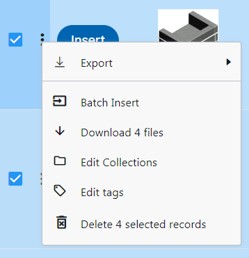

With this selection choose the three dots icon next to the boxes to see options for bulk operations.

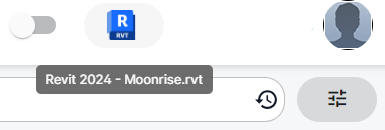

Batch Insert allows you to insert all content selected into the application you are connected to in the connections manager at the top right of Content Catalog.
Note all selected items must be for the same application you are connected to, in order to see this option.

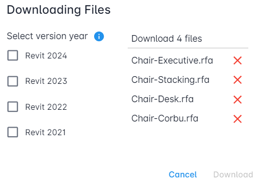

Download will allow for downloading of the content based on the support for that kind of content. Revit content is shown below.

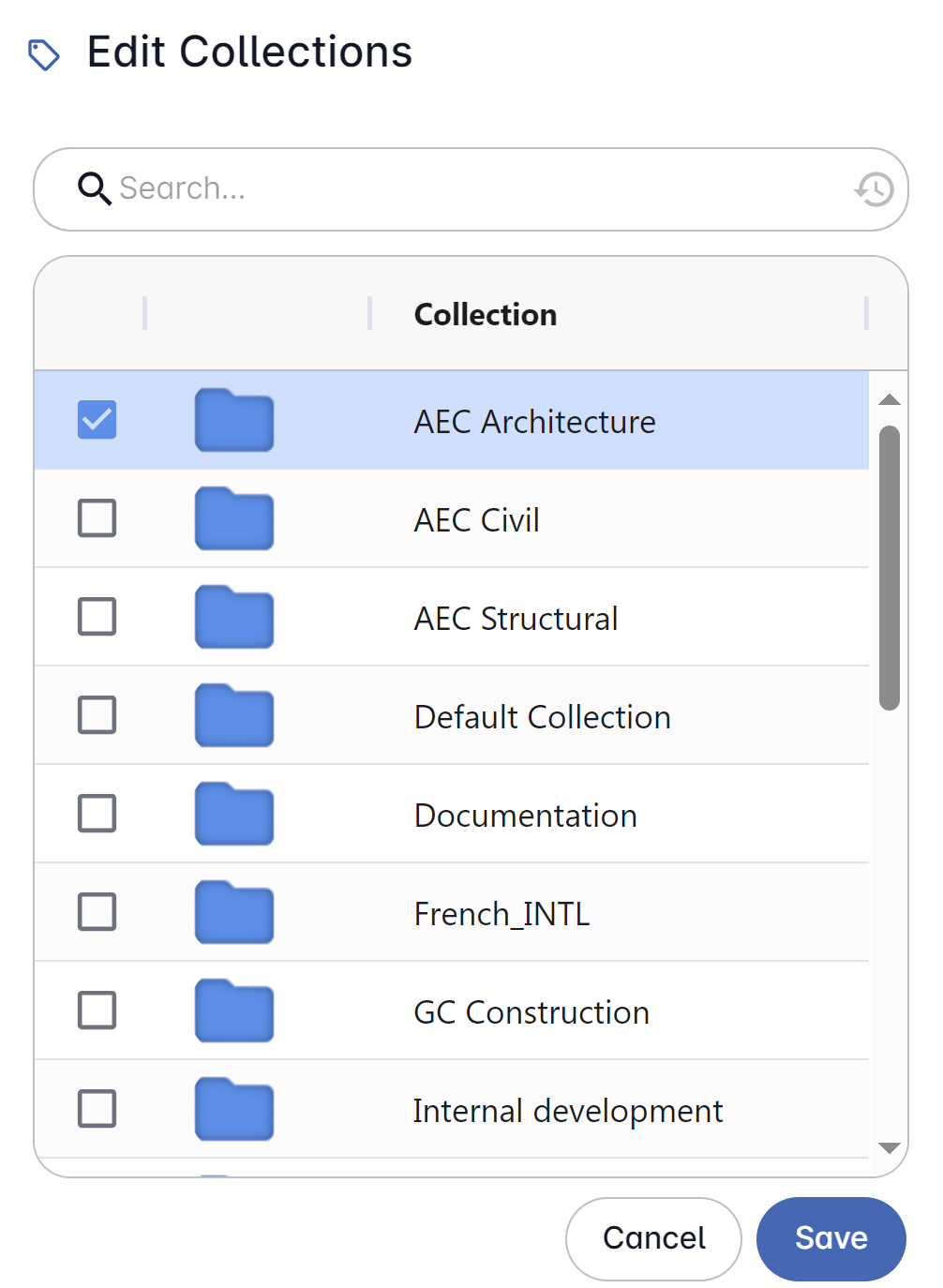

Edit Collections allows you to add or remove collection associations for all selected content.

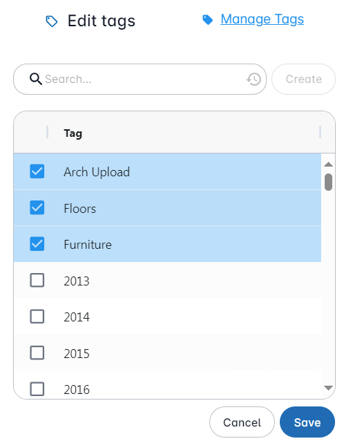

Edit Tags allows you to add or remove tag associations for content selected. Note: Manage Tags option will only be available for Content Catalog Admins.

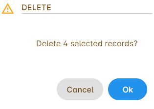

Delete allows you to delete the content selected.

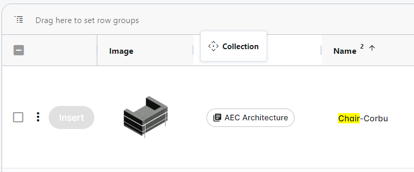

You can also use the Row Grouping feature at the top of the results area to group content in a way that aligns with your objectives. Just drag a column header to the top where "Drag here to set row groups" is displayed, as seen below.
