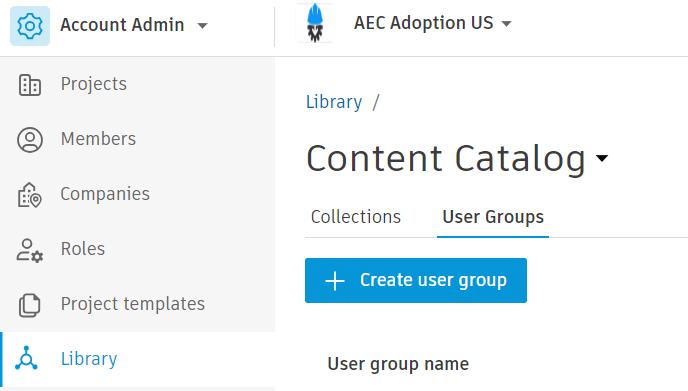

When creating User Groups in the ACC Admin Library for Content Catalog.
  1. Select the User Groups tab at the top.
    Pinned Collections

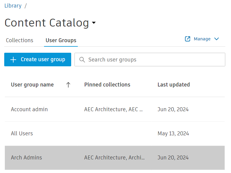

  1. Select the Group Name you would like to set pinned Collections for.
    Pinned Collections

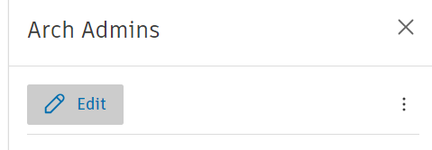

  2. Select Edit in the side panel that appears.
    Pinned Collections

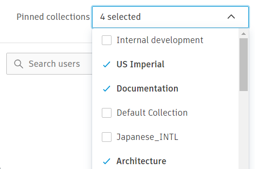

  3. Select the drop down to add collections that will appear pinned for this group. Then select Save.
    Pinned Collections
The Pinned Collections been successfully added for this group.
