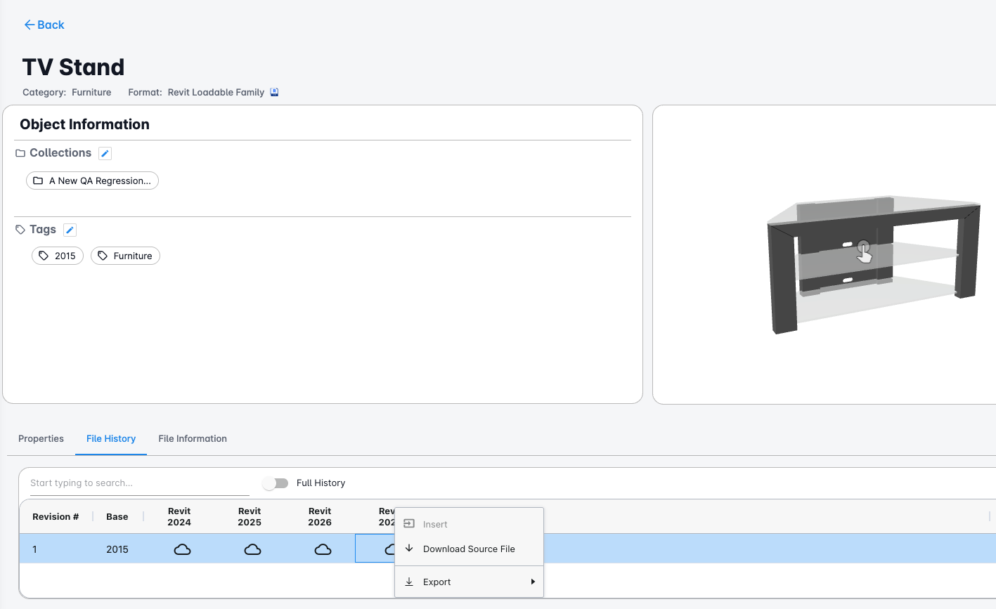

  • Available in the File History tab in File Details
  • Content Catalog will automatically create versions of when files are uploaded (ascending years only)

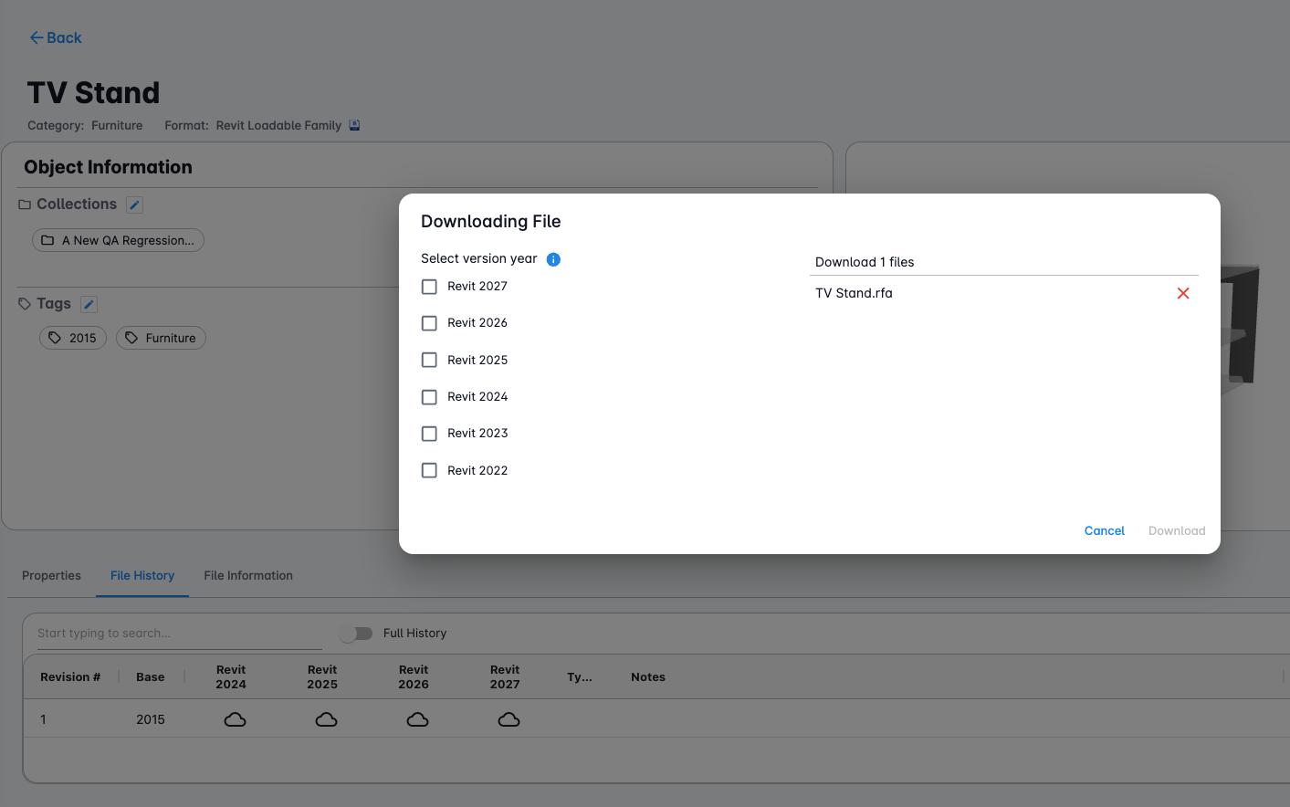

Versions 2022 and 2023: Will no longer be supported within Content Catalog workflows (e.g., File Details, Insert). Will remain available for download only (that were automatically upgraded by Content Catalog previously) to help customers maintain continuity where needed.
Base Version
  • The base version is the original version (e.g., a 2015 file) of the content uploaded to Content Catalog.
  • The base version of your uploaded content will always be retained and available for download.

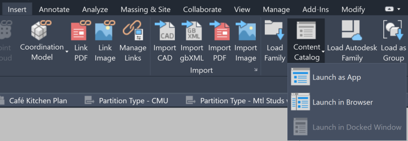

Toolbar location Revit 2025+
Starting in Revit 2025, the launcher for Content Catalog can be found in the Insert tab under the Load from Library panel.

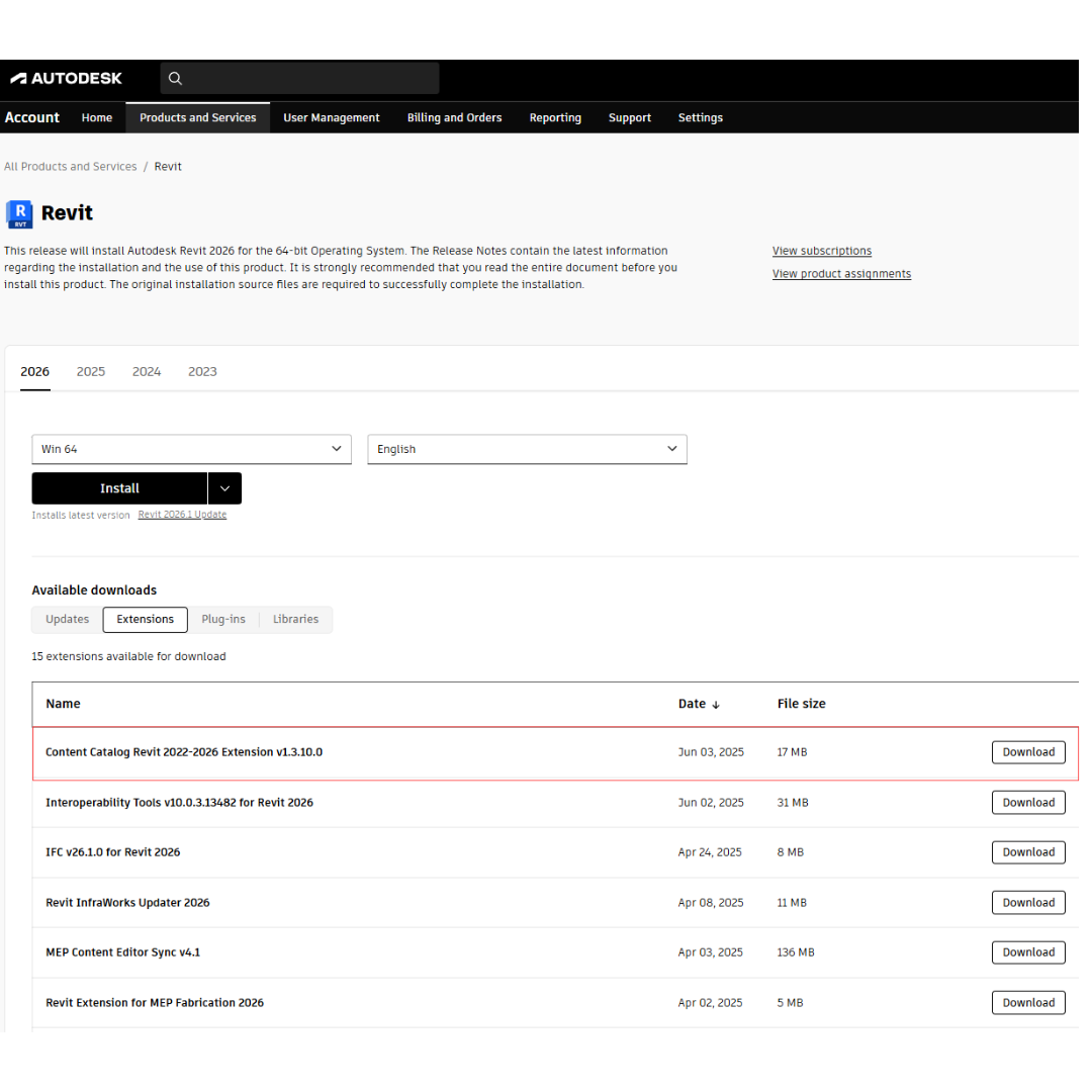

Revit Extension
Download and Installation
Version 1.3.12.3

In order to install Content Catalog Revit 2022-2026 Extension 1.3.12.3 you will need to uninstall previous version of the extension in add/remove programs.
