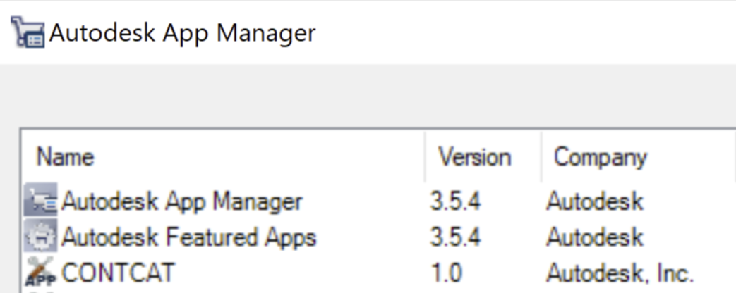

Note: Content Catalog does not appear on the ribbon in AutoCAD. To confirm installation check the Autodesk App Manager (Add-ins tab) to see that CONTCAT is installed as seen below.
