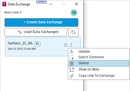

Delete a Data Exchange
You can delete the Data Exchanges that you created from your Civil 3D Connector interface.
  1. Click Data Exchange under the Collaborate tab.
  2. Select the relevant Data Exchange in the Connector interface.
  3. Click More menu and click Delete from the drop-down list.
    Delete Data Exchange
  4. A dialog box appears requesting your confirmation, click Yes.
    The selected Data Exchange will be deleted and a Data Exchange Deleted! pop-up will appear.

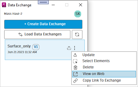

View Data Exchange on Web
This section explains how to view a selected Data Exchange from the loaded exchanges list on Autodesk Docs. When you select an exchange for viewing, you will be redirected to Autodesk Docs and the exchange will be displayed on a new web browser window.
  1. Select the relevant Data Exchange in the Connector interface.
  2. Click More menu and click View on Web from the drop-down list.
    View Data Exchange
    A new browser window opens where you can view the Data Exchange in Autodesk Docs.

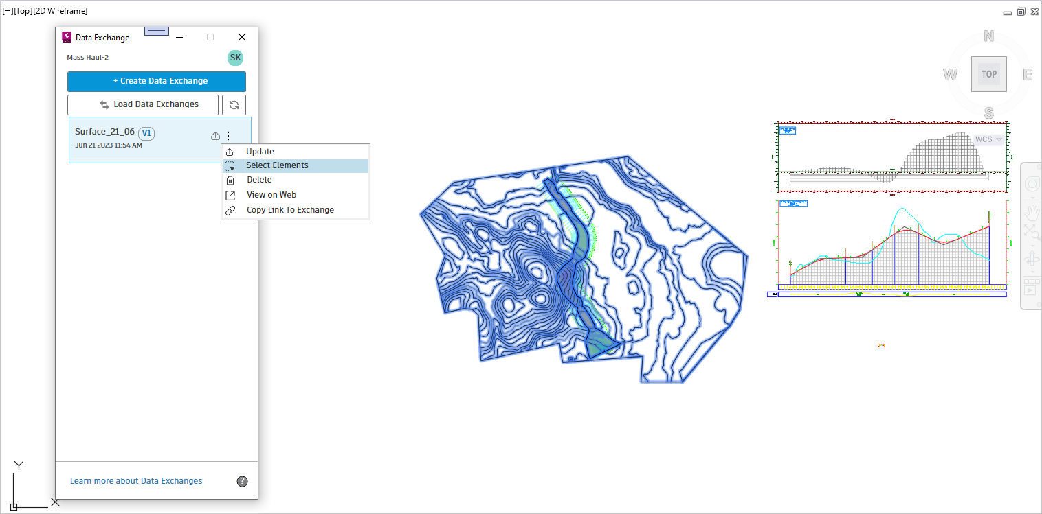

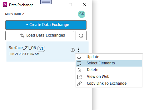

Select Elements of a Data Exchange
You can select the components from your Data Exchange using this feature. It helps you to identify the elements from a specific Data Exchange in your Civil 3D file.
  2. Click More menu and click Select Elements from the drop-down list.
    Select Elements
    It highlights the selected Data Exchange elements in Civil 3D.
    Select Elements
