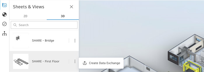

Select the Sheets & Views icon
Select the 3D tab.
Select the desired 3D Revit view.

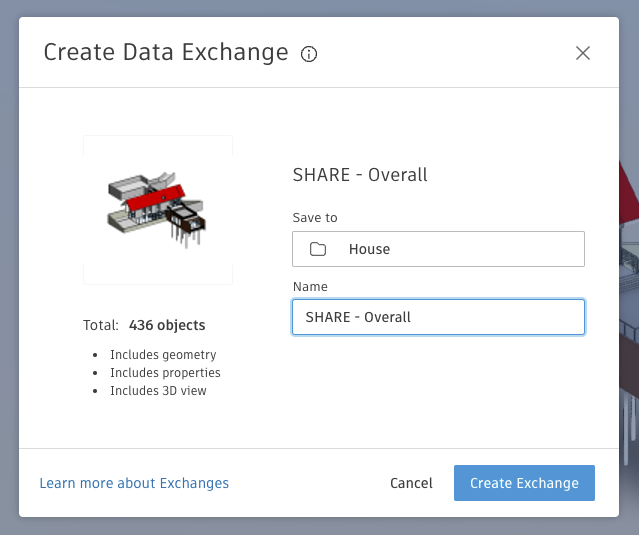

Click the More menu
Click Create Data Exchange.
Important: You can only create a Data Exchange from models published from Revit 2023 or later. A warning will display if the model is from an earlier version of Revit and you won't be able to create the Data Exchange.Click the Save to field and select a folder to save your Data Exchange.
See the Folder Permissions topic for more information about controlling folder access and file actions.
Click the Name field and enter a unique name for the Data Exchange.
If the selected folder is not enforced by the naming standard, click Create Exchange.

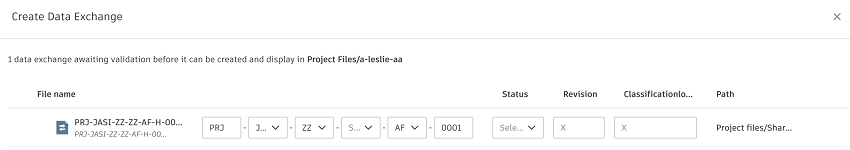

Naming standard enforced folder
If the selected folder is enforced by the naming standard
, the name of the Data Exchange will have to be validated.
Click Continue.
The name validator will open.
The file name will error if the Data Exchange name does not conform with the naming standard. You choose between two options:
- Edit the name now to conform with the naming standard
- If the Holding Area is turned on, you can choose not to correct the name now and continue creating the Data Exchange.
Create the Data Exchange.
If you have edited the name to conform with the naming standard, the Data Exchange will display in the selected folder.
If you have not corrected the name, the Data Exchange won't display in the selected folder until a project administrator has accessed the holding area and corrected the name.

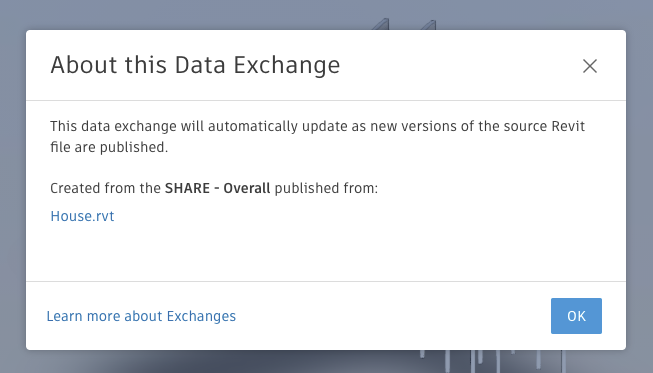

You can learn more about the Data Exchange source file, last updated by, and when it was last updated, by clicking
in the viewer.
If the information icon is red
, the Data Exchange may be out of date as it can't update automatically. See the Frequently Asked Questions help topic for potential causes and suggested solutions.
The Data Exchange versions up when the updated source Revit file is:
