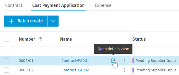

To add change order to cost payment application:
Navigate to the Cost Payment Application tab and open the details view of item you want to add a change order to.
Click Add Change Order.

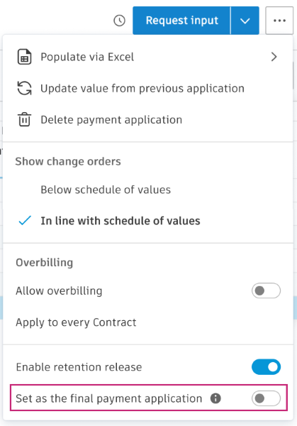

Set a Payment Application as Final
When creating or managing cost payments, there may be instances where a payment application needs to be marked as the final payment application for a contract. This indicates the completion of the project or a specific phase of the project and ensures that all retained funds can be released. Learn more about retention.
To set a payment application as final:
Go to the Cost tool, then switch to the Cost Payment Application tab.
Open the details of the Cost Payment Application you wish to set as final.
In the payment application details, open the More
menu.
Toggle the switch for Set as the final payment application.
Marking a payment application as final will trigger the release of all retained funds associated with the contract. Ensure that all work is completed and inspected before setting the payment application as final.

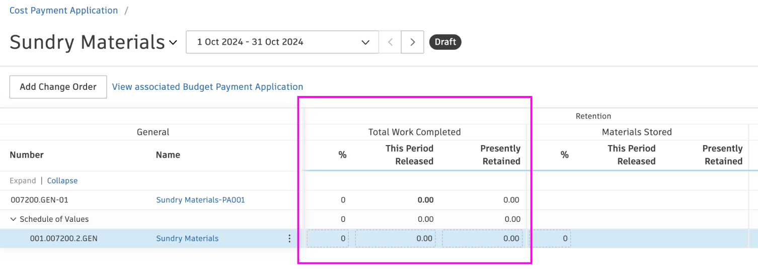

Work with a Schedule of Values after Creating a Cost Payment Application
After creating a cost payment application, there are a few rules to keep in mind:
- If a new Schedule of Values (SOV) is added, it won't appear in the existing cost payment application.
- If an SOV is deleted and the 'work completed' value is zero, it will be automatically removed from the existing cost payment application. If 'work completed' is not zero, an error will pop up when attempting to delete the SOV.
- When an SOV is updated (the amount), the update won't sync with the existing cost payment application.
- The next cost payment application that is created will synchronize with the latest structure and amounts of the SOV.
Learn more about the Schedule of Values.
