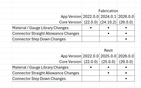

Issue: Failure to update to the minimum compatible version may result in the loss of data related to the material/gauge library, connector straight allowance, and connector step down.
Solution: Review the information in the table to determine the correct update version, then follow the steps below to update the MEP Fabrication software to the minimum compatible version.
