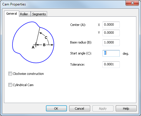

The General tab contains options that define the basic dimensions on which the specific cam attributes are based.
  1. Enter the Center coordinates for the cam. Center sets the X and Y coordinates for the center of the cam body.
  2. Enter the Base Radius, the radius of the circle that defines the body of the cam. This dimension is the minimum distance between the cam's center and the follower.
  3. Enter the Start Angle. Start angle defaults to parallel to the X axis. Enter an angle in degrees to move the start angle. The direction of rotation for the start angle is controlled by the Clockwise Construction option.
  4. Cams have a counter-clockwise construction by default. Select Clockwise Construction to construct the cam from sequential segments arranged in a clockwise rotation. Note that the Start Angle is also affected by this setting.
  5. If you have 4th-axis support, you can also create cylindrical cams or barrel cams. Design your cam as usual, and select Cylindrical Cam.
