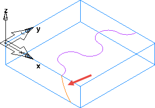

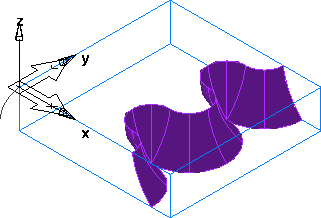

You can define the shape of the walls of a Boss, Side, or Pocket feature by specifying a cross-section curve. This curve is swept along the curve of the feature to create the overall shape. The curve must be:
  • in the XY plane, with the starting point of the curve at (0,0) in the setup axis, for example:
    use this cross-section curve:
    to create this feature:
  • in place on the feature curve, for example:
