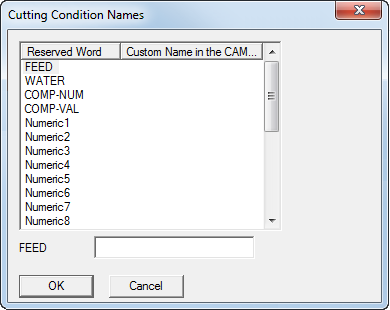

  3. Select the CNC-Info > Cutting Condition Names menu option. The Cutting Condition Names dialog is displayed.

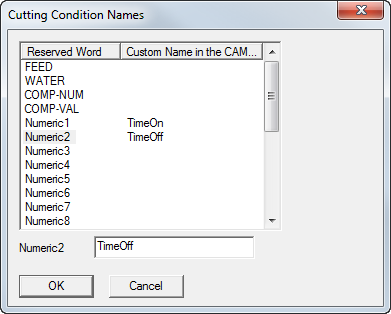

  4. In the Reserved Word column, select the condition you want to customize, and type the name you want to use in the box at the bottom of the table. The name is displayed in the Custom Name column of the table. For example:
  5. Repeat step 4 for each reserved word you want to customize.
  6. Click OK to save your changes and close the dialog.

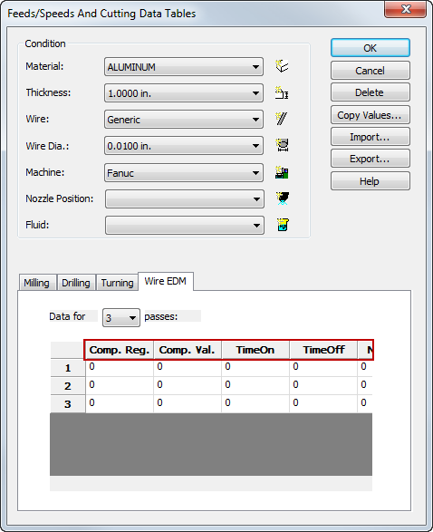

The names are displayed on the Wire EDM tab of the Feeds/Speeds And Cutting Data Tables dialog when you next view the stock settings for the post. For example:

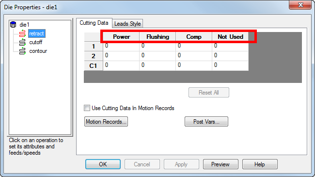

They are also displayed on the Cutting Data tab of the Feature Properties dialog in FeatureCAM:
