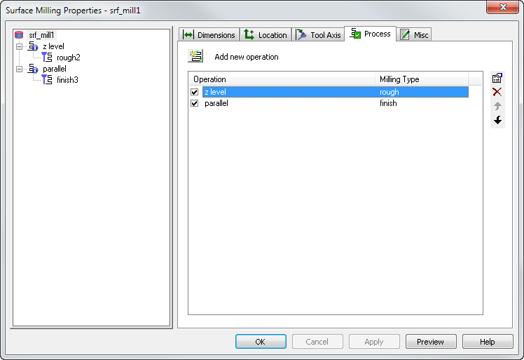

Process tab
The Process tab lists the operations that are included for milling the feature in the order they happen. You can remove operations by deselecting them. This enables you to customize operations and then turn them off to reduce screen clutter when working on subsequent operations.
The buttons have these functions:

Move item up changes the order of operations in the milling feature by moving the selected operation up one place in the list.
Move item down changes the order of operations in the feature by moving the selected operation down one place in the list.
Delete operation removes an operation from the feature. You can disable an operation instead by deselecting the operation. The check box, when set, includes that operation in the feature.
