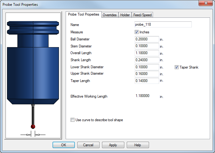

Probe
Ball Diameter
Stem Diameter
Overall Length
Shank Length
Lower Shank Diameter
Upper Shank Diameter
Taper Length
Taper Shank — Deselect this option to have a shank with a constant diameter and enter the Shank Diameter instead of Lower Shank Diameter and Upper Shank Diameter.
Name — Enter a name that identifies the tool. The name must be unique among all the tools in the crib.
Measure — This indicates the units that are used for reporting the tool’s dimensions. Select Inches for inch units or deselect it for millimeters.
