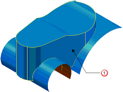

Selected Surface

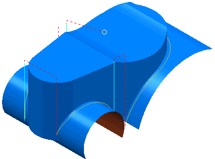

Use the Surface control tab to determine whether you swarf cut:
  • on the inside:
  • or outside of the surface:

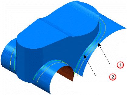

On theMilling tab you can set:
  • Axial offset — offsets the lowest position of the toolpath along the tool axis.
  • Leave allowance — specifies the amount of stock material to leave after the cut.

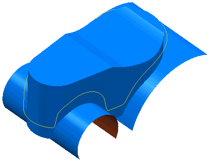

    Using Leave allowance
    No Leave allowance

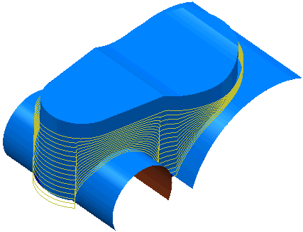

  • Multiple Cuts — This allows multiple toolpaths with a Z-increment setting.
