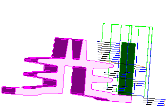

The Flowline technique projects the isolines from one surface onto the surfaces of the feature. The isolines are projected in the direction of the surface normal. In the example below, the isolines of a flat surface are projected onto the part. By using a side mill cutter, Flowline machining can be used to machine undercut regions.
