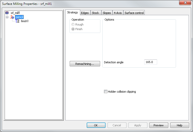

Strategy tab (Pencil)
Detection angle — Only corners below the angle specified are found.
Remachining — Click this button to open the Remachining dialog.
Holder collision clipping — Clips the toolpath where the holder or shank collides with a part surface, check surface, or unmachined stock. When selected, the Holder clearance and Shank clearance attributes are displayed on the Milling tab for the operation.
