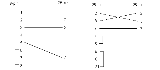

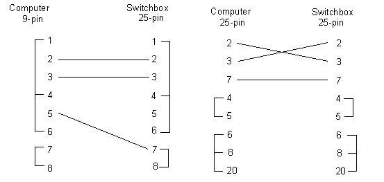

Cables
You need an RS-232 adapter cable to connect the computer to the communications cable leading to the CNC machine. The adapter cable may also be used to connect the computer to a serial port expander (ABC switch box). The adapter cable can be plugged into the COM1 or COM2 port, at the back of the main unit.
Note: The cable can be a 9-pin or 25-pin connector at the computer end. The manual contains an illustration of the required wiring pattern for the cable.
Serial port pinouts
The necessary communications cables for connecting the computer to any device or CNC control can be made with parts available from most electronics supply stores. The pin functions for a standard 25-pin RS-232 port and a standard 9-pin RS-232 port are shown below. Check your computer owner's manual for the correct information.
