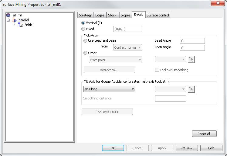

4-Axis/5-Axis tab
You can use the 5-Axis tab of the Surface Milling Properties dialog to edit the Multi-Axis options of a Surface Milling feature.

This tab enables you to set three different things: Tool Axis, Tilt Axis for Gouge Avoidance, and Tool Axis Limits. The first two sections of the dialog can be confusing because they both control the tilt of the tool axis. Think of the first section, Tool Axis, as a first level of tool tilting, controlled in a manual way. And then you can add extra tilting to avoid gouges with the tool holder by using Tilt Axis for Gouge Avoidance.
Note: You can use these two sections of the dialog independently, one without the other, meaning that you can use the second section without having specified any tilting in the first section.
The Tool Axis enables you to define the tool orientation. The default value is Vertical, which is used for standard 3-axis machining. However, it can also be a continuously changing orientation for so-called 5-axis simultaneous machining.
