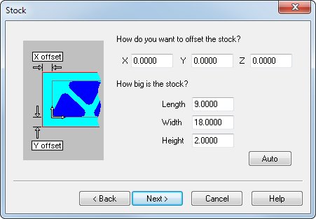

Stock dialog (multiple fixtures)
You can use the Stock dialog to specify the size and location of the stock:
  1. Enter the coordinates of the stock origin in the X, Y and Z fields.
    The default block size is calculated as the minimum block size that will contain all the parts in the document with the spacings specified in the Configuration dialog.
  2. If you want to use a stock with a specific size, enter the dimensions in the Length, Width, and Height fields.
  3. Click Auto to calculate the minimum block size that will contain all the parts.
  4. Click Next to display the Preview dialog. A preview of the layout is displayed in green in the graphics window.
