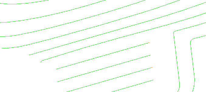

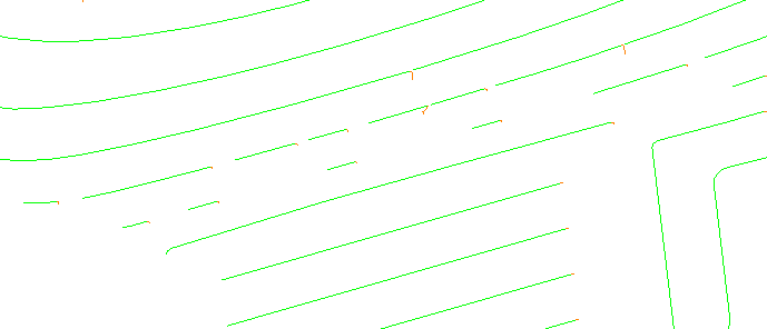

Minimum gap length — Enter the gap length, which controls fragmentation by replacing gaps shorter than this distance with a toolpath segment. A large value reduces fragmentation, but increases the length of the toolpath that is not cutting material. A small value produces shorter toolpaths, but increases the number of toolpath lifts.
  • A Minimum gap length of 0:
  • A Minimum gap length of the default value:
