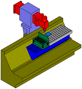

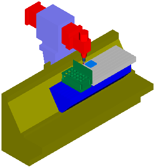

Show edges — Select this option to outline the edges of the machine during machine simulation.
This example shows the default behavior with Show edges deselected:
This is the same example with Show edges selected:
