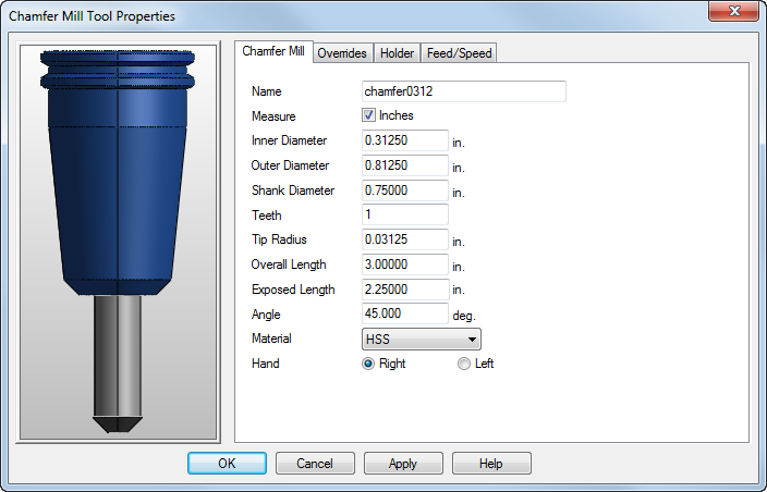

Chamfer Mill tools are used for chamfer features or for chamfering large diameter holes.
Name — Enter a name that identifies the tool. The name must be unique among all the tools in the crib.
Measure — This indicates the units that are used for reporting the tool’s dimensions. Select Inches for inch units or deselect it for millimeters.
Inner Diameter — See diagram.
Outer Diameter — See diagram.
Shank Diameter — See diagram.
Overall Length — See diagram.
Exposed length — This is the amount of the tool that sticks out of the holder if the holder is simulated.
Tool material — This indicates what the tool is made of. This information is important when calculating the feeds and speeds.
Hand — Set whether the tool is Right-handed or Left-handed.
Inner Diameter
Outer Diameter
Shank Diameter
Overall Length
