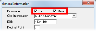

  1. In XBUILD, select General from the CNC-Info menu.
  2. In the General Informationdialog, in the Dimension field, select whether the post is in Inch or Metric units, or both. We recommend posts that support both units.
  3. Click OK.

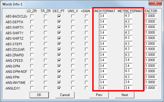

  4. Choose Words-1 from the CNC-Info menu.
  5. In the Words Info dialog, update the Format to specify the number of digits before and after the decimal points for each linear positional word. Typically, 3.4 is used for inch posts, and 5.3 is used for metric posts.
  6. Your post type may contain several pages of the numeric words. Click Next to display the next set of Words Info. Repeat steps 4 through 5 to change all the linear positional words for your post type.
