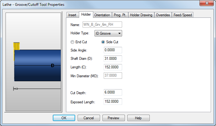

The Holder tab for Groove/Cutoff tools, contains these attributes:
Name — Specifies the name of the current tool.
Note: To edit the Name of the tool, use the Insert/Type tab.
Holder Type — For grooves possible holder types are:
  • OD Groove — Select this option for outer diameter grooving tools.
  • ID Groove — Select this option for inner diameter grooving tools.
  • Face Groove — Select this option for face grooving tools.
  • Cutting — Select this option for cutoff tools.
End Cut — The tool cuts in a direction parallel with the length of the holder.
Side Cut — The tool cuts in a direction perpendicular with the length of the holder.
End angle
End clearance
Side angle
Side clearance
Shaft Diam. (D)
Length (C)
Tip angle
Width
Tip radius
Min/Max plunge dia.
Cut Depth — This is the maximum depth of cut.
Exposed length — This is the amount of the tool that sticks out of the holder if the holder is simulated.
