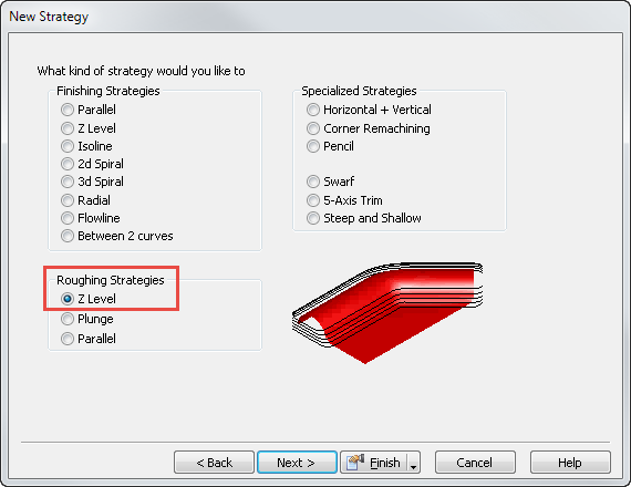

  4. In the New Strategy page, select Choose a single operation, then click Next.
  5. Under Roughing Strategies, select Z Level, then click Next.
