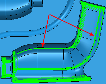

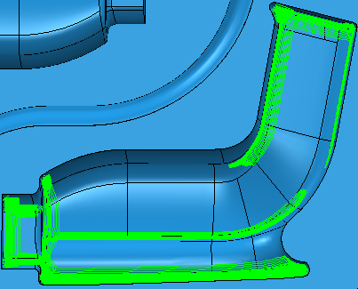

Detection limit — Enter an angle so that PartMaker machines only corners that are sharper than this angle. 165
is the default value. This works well for most corners. However there are instances where you need to increase this value to detect the corner regions in which you are interested.
- With a Detection limit of 165
- With a Detection limit of 170
