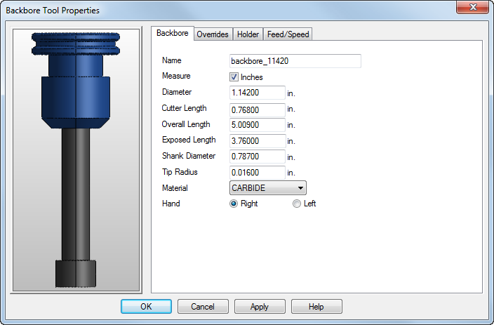

Backbore tools are used for drilling Backbore Hole features.
Name — Enter a name that identifies the tool. The name must be unique among all the tools in the crib.
Measure — This indicates the units that are used for reporting the tool’s dimensions. Select Inches for inch units or deselect it for millimeters.
Diameter — See diagram.
Cutter Length — See diagram.
Overall Length — See diagram.
Exposed length — This is the amount of the tool that sticks out of the holder if the holder is simulated.
Shank Diameter — See diagram.
Tip Radius — See diagram.
Tool material — This indicates what the tool is made of. This information is important when calculating the feeds and speeds.
Hand — Set whether the tool is Right-handed or Left-handed.
Diameter
Cutter Length
Overall Length
Shank Diameter
Tip Radius
