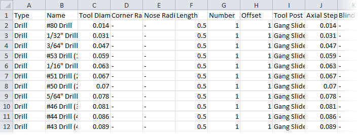

PartMaker can work with a Master Tools Database file to transfer tool data to and from PartMaker. The Master Tools Data file is stored in a PartMaker Tool Database file (.tdb) or a comma-separated values (.csv) file. Master Tool Database files are language-specific, so must match the language your PartMaker application uses.
The .csv file contains a single, continuous list of tools, including the tool parameters for each tool. If a particular parameter is not relevant for a tool, a dash (–) is shown. For example:
When you open a .csv file from the Manage Tools Files dialog, PartMaker displays all tools from the file that match the display criteria you have specified. PartMaker ignores any data in the file that it does not recognize as PartMaker tool parameters.
