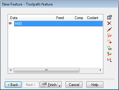

Program stop code example
To enter program stop code directly into the NC program:
  1. Select Features & Manufacturing tab > Features > Toolpath > Milling Toolpath.
  2. In the New Feature - Curve or Operation page, select NC code text and enter M00 (or M01).
  3. Click Next. The New Feature - Toolpath feature page is displayed.
    This page has the same toolpath editing buttons as the Toolpaths tab in the Toolpath Properties dialog.
  4. Click Finish. The Toolpath feature is listed in the Part View and on the Op List tab.
  5. Simulate the Toolpath feature. In this example, there are no toolpaths to see, but you must simulate the feature to produce the NC code.
  6. View the NC code on the NC Code tab.
