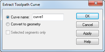

Extract Toolpath Curve dialog
To display the Extract Toolpath Curve dialog, click Export toolpath as curve on the Toolpaths tab of the Milling Feature Properties dialog.
The Extract Toolpath Curve dialog allows you to create a curve from a toolpath. If you want to create a single curve, enter the name for the curve and click OK. If you want to create arcs and lines, click the Convert geometry. If you want to output only a few segments of a toolpath, select a range of moves and select the Selected segments only option.
