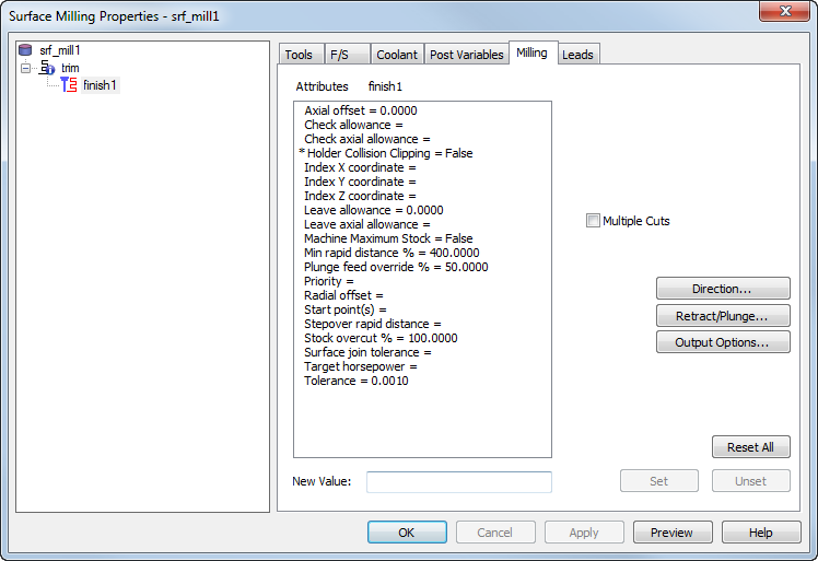

Milling tab (5-axis trim)
5-axis position menu — There is often an alternate orientation option for accessing a face. Select from:
  • Standard — The default orientation.
  • Alternate — The alternative orientation to the default.
  • Use Post Preference — Uses the position (Positive or Negative) set in XBUILD in the Five Axis dialog for the Preferred orientation of the primary rotary axis option.
  • Use Axis Limits — Allow FeatureCAM to select the orientation that best fits within the axis limits set in the MD file.
Axial offset — This attribute offsets the lowest position of the toolpath along the tool axis. Positive numbers offset the toolpath towards the tool holder, negative numbers away.
Check allowance — Enter the minimum distance that you want to leave around check surface(s). If left blank for a roughing pass, the Finish allowance value is used. If left blank for a finishing pass, the Leave allowance value is used. You can enter a positive or negative value. Set Check surfaces on the Dimensions tab.

New Value — To change the value of an attribute in the list, first select it, then enter the new value. Click the Set button to save the new value.
Output Options — Click this button to open the Output Options dialog.

Reset All — Click this button to reset all of the attributes on the tab to their default values.
Retract/Plunge — Click this button to open the Retract and Plunge dialog.
Start point(s) — Override the default start point(s) of a toolpath by entering the name of a curve that, when projected, intersects the toolpath at the point you want. You can use a curve with multiple segments to set multiple start points for a toolpath, and alternating segments are used to set the start points.
Set — You must click the Set button to save a New Value for the selected attribute.
Note: If you change the value of a numeric attribute, the attribute name is prefixed with a * in the attribute list after you click Set.

Unset — Click this button to return the value of the selected attribute to its default value.
Note: If you have changed the value of a numeric attribute, its name is prefixed by * in the list.
