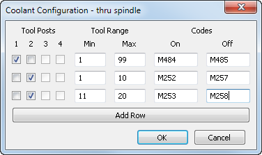

Coolant Configuration dialog
Use the Coolant Configuration dialog to specify different coolant on and off codes depending on the turret and tool being used.
To display the Coolant Configuration dialog, select Multi-code and click Configure in the Coolant dialog.
To use multi-code coolant:
  1. For each row, select the Tool Posts for which you want to specify the On and Off Codes.
  2. Enter the Tool Range, the range of tool numbers for which you want to specify the On and Off Codes.
  3. Enter the On and Off Codes.
  4. Click Add Row to add more rows if required.
  5. Click OK to close the dialog.
