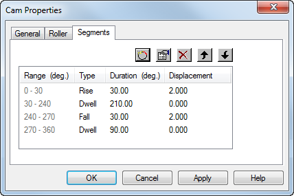

For example, if you create a barrel cam that is wrapped around the X axis with these parameters:
the following curve is created:
Notice that the displacement is in the X direction. If you create a groove feature using the barrel cam curve, you get the toolpath shown below.
