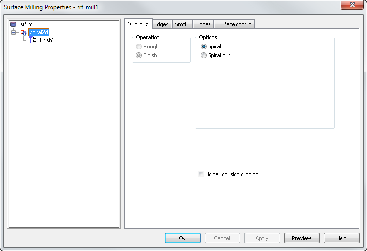

Strategy tab (2D spiral finish)
Spiral in — Select this option to spiral from the edge in toward the center.
Spiral out — Select this option to spiral away from the center.
Holder collision clipping — Clips the toolpath where the holder or shank collides with a part surface, check surface, or unmachined stock. When selected, the Holder clearance and Shank clearance attributes are displayed on the Milling tab for the operation.
