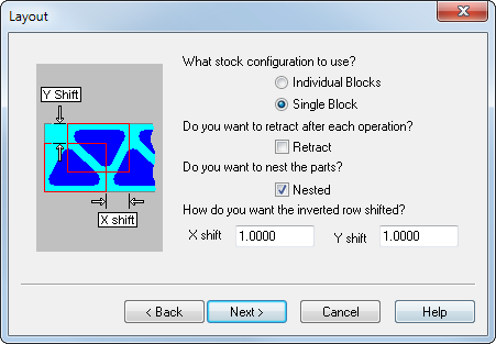

You can set the following nesting options in the Layout dialog:
NestedFeatureCAM rotates and flips the part geometry to find the most efficient layout, to reduce the waste material when cutting some parts.
X shift and Y shift — The distances between the origins of nested objects in the X and Y axes.
Note: These options only applies to the inverted row or column; the spacing between objects on the same row or column is dependent on the X spacing and Y spacing values in the Configuration dialog.
Note: These options are only available if Nested is selected.
Tip: You can enter negative values.
Click Next to display the Preview dialog.
