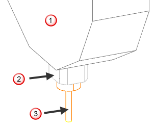

      - Turret
      - Tool block
      - Lathe tool

      - Turret
      - X tool block (OD mount)
      - X tool

      - Turret
      - X tool not mounted on OD block
      - X tool

      - Turret
      - ID or Z tool block
      - Z tool and holder
