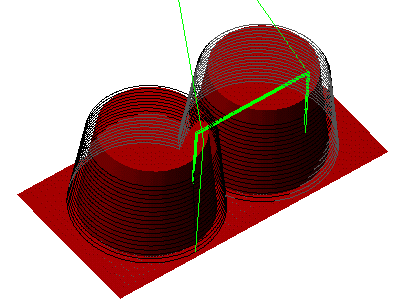

The Z-level finishing method slices the feature at various depths, and then mills each slice.
This is a good technique for finishing steep walls or when you require a consistent depth of cut. This technique is sometimes called waterline milling. Just like Z-level rough, it starts with slicing the model and then creating toolpaths from the slices.
Here is an example of Z-level finishing:
