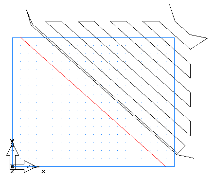

    All stepover
    The All Stepover attribute adds a lead-in and lead-out to each stepover move for an open feature.
    This example shows the behavior with All Stepover deselected.
    And with All Stepover selected:
