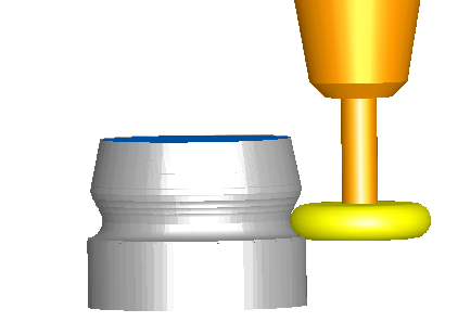

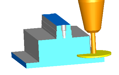

You can cut undercut regions with either an Isoline operation or a Flowline operation.
To machine undercut regions, you must.
  1. Create an Isoline or Flowline operation.
  2. Select an appropriate side mill cutter. FeatureCAM does not automatically select side mill cutters.
  3. Specify a Horizontal lead-in/out plane on the Leads tab. You may also have to experiment to determine an appropriate Ramp diameter to prevent gouging.
