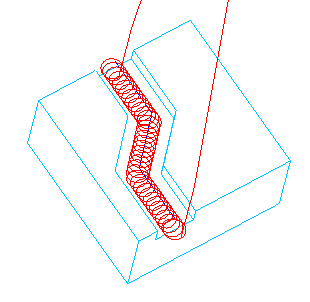

Tip: Simple grooves have an option of using a trochoidal toolpath. Instead of a simple slotting cut, the tool uses a series of circles to clear away the metal, as shown below. This toolpath has the advantage of reducing the load on the tool.
