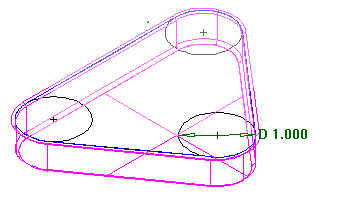

In the image below, a pocket was created from a curve, which was created from a series of circles connected by tangent lines:

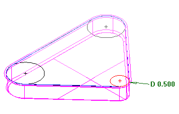

By editing the diameter of one of the circles, the end points of the lines change, the curve changes and the pocket changes as shown below:
