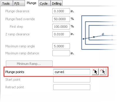

You can use a curve to specify multiple Plunge points or Start points for an operation.
To specify multiple plunge or start points:
  1. Create lines with end-points on the locations you want to use as the plunge or start points.
  2. Chain the lines into a curve.
  3. In the Feature Properties dialog, in the Plunge tab, select your curve as the Plunge points or Start Point attribute, for example:
Example:
