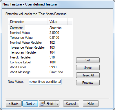

Test Abort/Continue
Comment — The comment is output in the NC code at the start of the test feature.
Result Register — This is where the result of your probing measurement is placed. For example, if you know that your machine uses register 510, enter 510 for this value.
Continue Label — Enter the place to jump to in the code if the program wants to continue after this test feature. You can create a new jump label using the Test Jump Label feature.
Abort Label — Enter the place to jump to in the code if the program wants to abort after this test feature. You can create a new jump label using the Test Jump Label feature.
