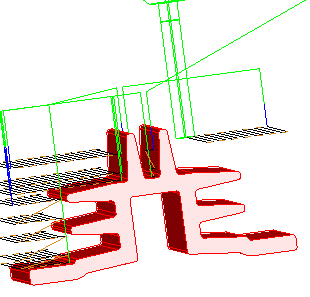

With Reorder off, each Z level is roughed completely before moving to a lower depth.

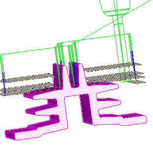

With Reorder on, paths are created that machine vertical regions as shown below.
